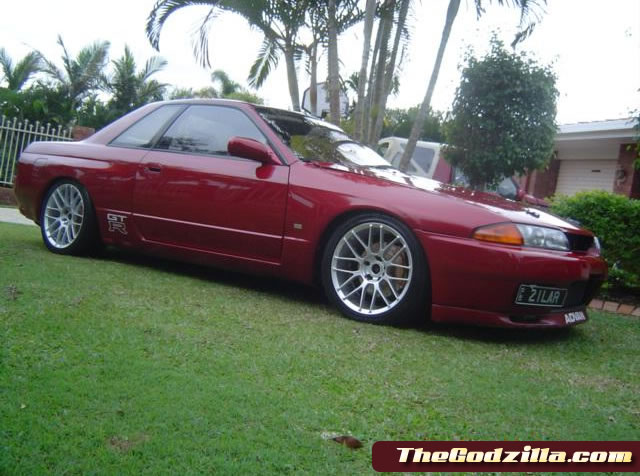

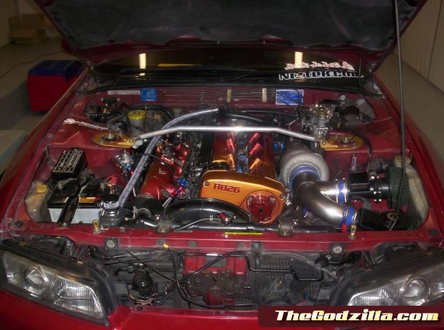

Hey guys,
Been lurking around here for a while but decided to join.
Here is my R32 GTR
I havent driven it with the single turbo on it yet as it spun a big end on the dyno due to a poor rebuild. Its getting rebuilt again now. it only got 370HP at the wheels because it had stock injectors. That was at 12psi. But I will have bigger injectors after this rebuild so boost can go up to around 23psi.

Nice engine bay, and color!
Engine details please

hey,
I had a list of mods but dont know where it is. so i see what i can think of
gt35/40r turbo 7oohp
stanless highmount manifold
3.5inch front/dump/3inch cat back - all stainless
700hp fuel pump
33 gtr crank
had arias pistons, but they died on teh dyno, now going CP because they are quieter
billit rods
oil catch can
power FC
only standard afms for now. soon Z32 will go on
few other things but cant remember em.
hoping for 580HP at the wheels
