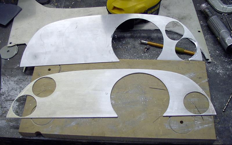

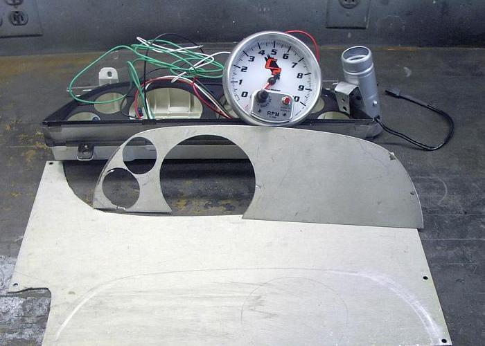

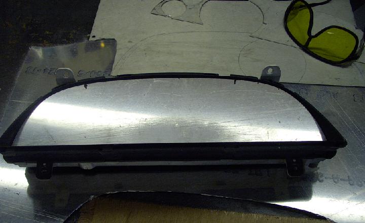

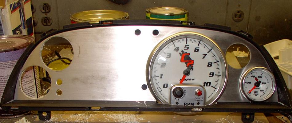

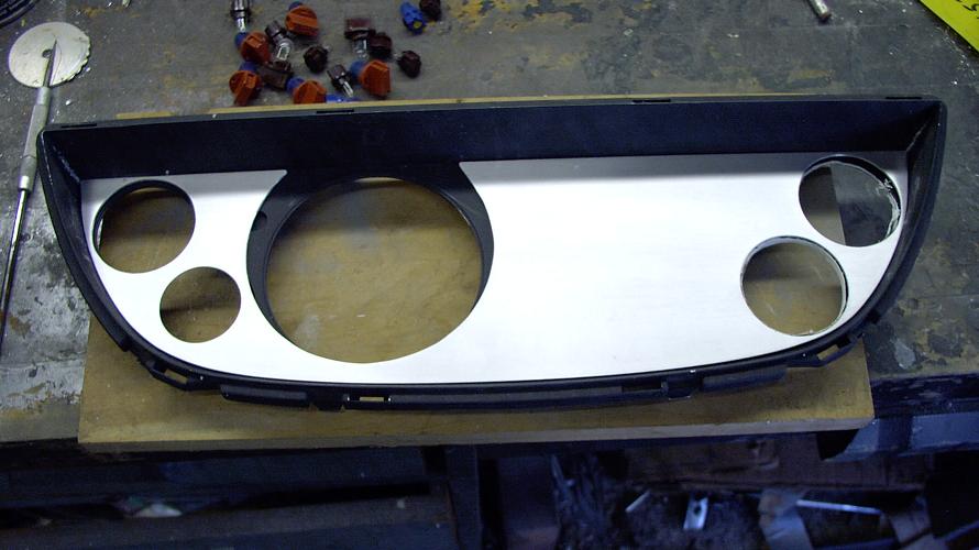

I am in the process of installing a custom Autometer gauge cluster. Pics are worth a 1000 words, so here goes.
Attached Thumbnails Custom Instrument Cluster-c2-tach-install.jpg   Custom Instrument Cluster-damn-gotta-start-over.jpg   Custom Instrument Cluster-c2-starting-over.jpg   Custom Instrument Cluster-c2-drawing-outline.jpg   Custom Instrument Cluster-c2-fine-tuning-fit.jpg

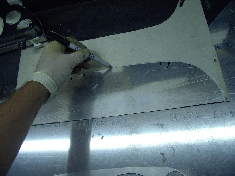

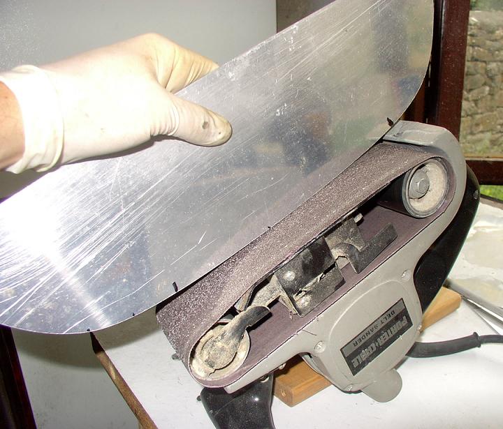

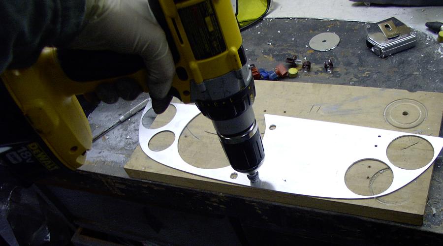

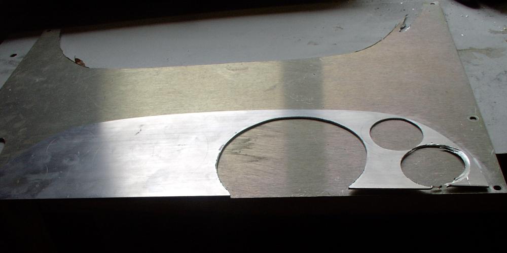

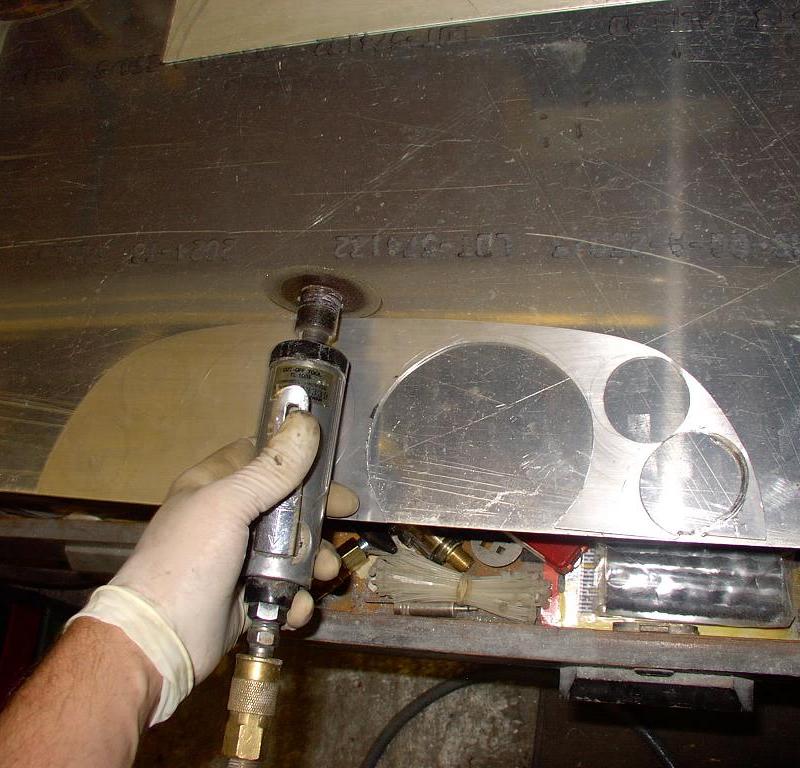

It is a lot more labor intensive than most people think. If it wasn't, a lot more people would do it, right.
The number 2 pic, you can see on the top plate, the hole saw caught the metal, and wrinkled it, so I had to make another one. The second one was a lot easier, since most of the shaving had been accomplished on the first on to get it to fit.
Attached Thumbnails Custom Instrument Cluster-c2-markings-shaving-material.jpg   Custom Instrument Cluster-c2-number-2.jpg   Custom Instrument Cluster-c2-template-stock-cluster.jpg   Custom Instrument Cluster-c2-marked-ready-more-grinding.jpg   Custom Instrument Cluster-c2-turn-signal-griding.jpg

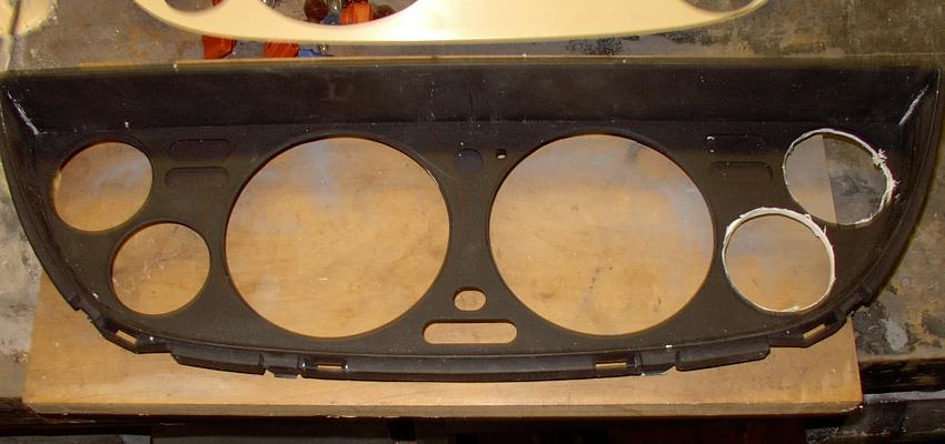

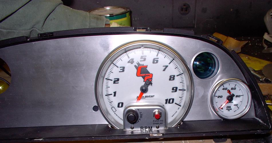

Getting there, still have a few more things to do.
Any comments, or ideas?
Attached Thumbnails Custom Instrument Cluster-c2-quick-look.jpg   Custom Instrument Cluster-c2-still-work.jpg
