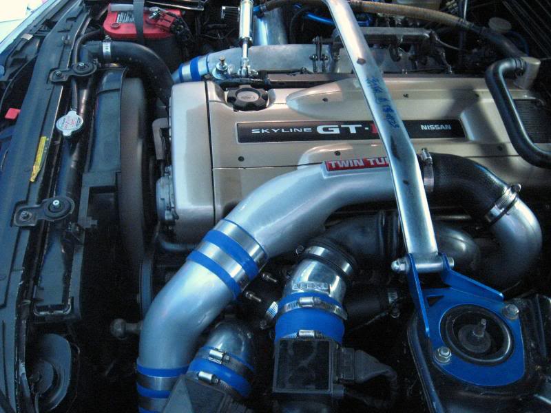

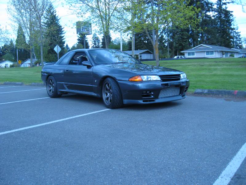

I was holding back pictures and information as this is a Z forum, my apologies here are some. I'm also including a list of Mods.
Hi I'm in WA retired from the Army in 2006. Brought my Skyline from Okinawa in 2004 through Motorex, after 2 years and painfull litigation recovered my car. I'm currently boosting 1.7 but only on race Gas and that nets me somwehere around 528 WHPm being conservative. On 92 I only boost 1.2 and I get around 400 and some change to the wheels. I've owned and driven Skylines since 1987, my wifes first car was a Skyline I bought for $75. I've lived in Japan for a total of 7 years 4 months, studied Japanese at DLI for 13 months. Most of what I know about Japan is from okinawa.
Engine modifications
• Bored 40 over
• Wiseco Skirted pistons
• Corilla Rods with ARP
• Polished and balanced Crank
• Cosworth bearings
• ATI damper
• Long block balanced with Damper, flywheel & clutch components minus disks attached
• N1 oil pump
• N1 water pump
• Bullion high flow 65degree Celsius thermostat
• Greddy timing belt
• Apexi cams 266 9.0 intake 268 9.0 exhaust
• Tomei cam gears
• HKS step 2 springs
• Cometic head gasket
• HKS 2530 turbines
• HKS down pipes
• HKS 3 core GT Hybrid intercooler
• Z32 MAFs w/Apexi intakes
• RSR front pipe 70mmX2 80mm
• HKS Silencer exhaust
• Sard 720 injectors
• Tomei fuel pump
• Nismo fuel regulator
• Nismo engine mounts
• Nismo Transmission mount
• Z32 fuel filter
Engine management modifications
• Apexi PFC L Jetro with Data-logit
• Blitz Dual SBCR boost controller
• AEM AFM
