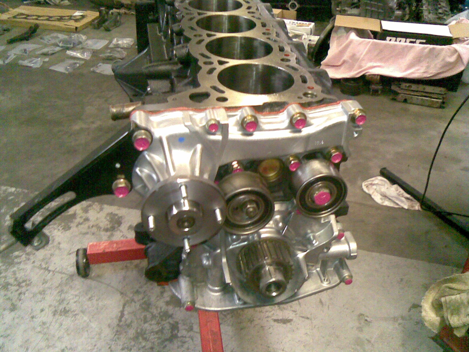

Hey guys im from Australia just joined the forum to see what the american style of jap tuning is like and there seems to be some wicked cars getting around. At the moment im currently rebuilding my r33 gtst with a full house rb26det engine conversion ill put some info and pics up..
Engine: RB26DET conversion out of a r32 gtr, bought the engine from perth as a good runner got it over here pulled here down to have a look inside and found 6 scored bores 1 stuffed piston and a main and big end bearing f*cked although block turned out to be a N1 item with 24U stamped on it. Polished and details engine bay

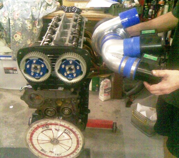

Currently in the process of rebuilding the engine with ross racing forged pistons, prepped and shot peens rods, ARP rod bolts, bottom end stud kit prepped crank, detail engine block, fully ported head, stage 2 tighe cams with 272in and 264 ex, cam gears, n1 oil pump and water pump, 700cc sard injectors, sard fpr, modified fuel rail, custom exhaust manifold, garrett gt3082r turbo with both .82 and 106 housings, tial 44mm wastgate, nispro ecu, bosche 044 and 3/8" aluminium lines and 2l custom surg tank, jjr alloy radiator, trust intercooler, nismo clutch and lightened fly wheel.

Greddy adjustable cam gears
