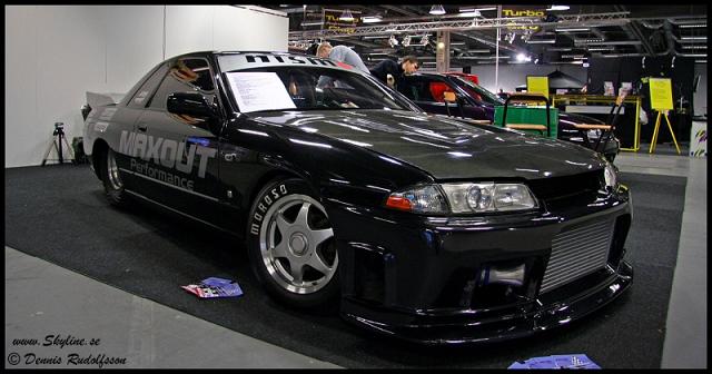

My sky is modified for dragracing
if interested i can post full spec and more pics

Very nice car. Have you raced your car yet? If so what are your times?

yep welcome to the fourm!!! I love skyline, can gimme the pictures? Or you wanna trade for gran turismo4 ones????

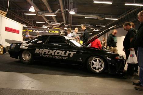

Modified RB26DETT N1 Engine
Runs on Alcohol
very modified cyl.head
custom made cams ,valves ,springs,retrainers,
machined ,ported ,flowtested and much more
custom inlet with 90mm trottle.
rustfree Exh,manifold with a modified Garret GT42 R BB TURBO
modified 55 mm AMW Wastegate
80 mm G,E,T dumpvalve
steel crank
Carillo rods, JE pistons (all modified for larger piston bolt )
Bosch 1600 cc injectors and 3 bosch motorsport fuelpumps
3 bosch motorsport fuelregulators
concrete filled engine block. to prevent cracks in the block
at high outputs (they do crack, trust me)
very modified cooling system.
6 separate waterinlets at the top of the enginebock on exh,side
and 6 separate wateroutlets on inlet side of cyl,head
so each cyl have its own cooling flow .wich secure even temp in all cylinders
the cooling system is runned by a external electric temp regulated waterpump
and a Large Griffin watercooler from a chevy big block
oil system is a Moroso dry sump system from a Chevy big block

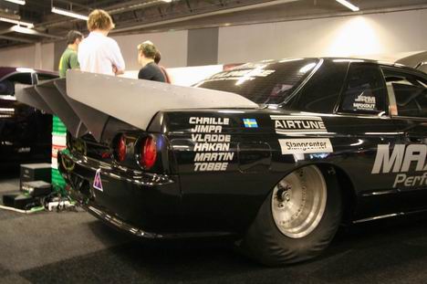

Engine and gearbox is moved back 15 inches for better weight ratio
It`s also modified to LHD
full rollcage.
chevy TH 400 Auto, very modified for drag racing
6000 rpm stall Drag Turbine
with transbreak and much more
shortened Ford 9" rear axle with four link
M&H 31" slicks rear and Moroso 4" frontrunners
wheelie bars
Nitrous
and much more

forgot to tell that it has not yet made any time trials at the strip yet
we are working with the chassie , trying to get the right reactions in the car before we make any atempts at the track
